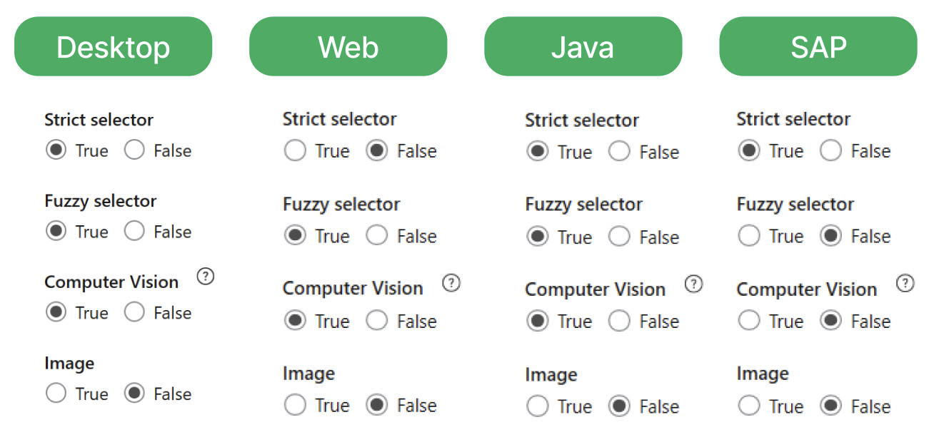

Fuzzy selectors are recommended by default especially for Web (where Strict is disabled), but also for Desktop and Java. For SAP we recommend using Strict selectors alone:

Thank you, good to know it is among your plans! And thank you for informing me about the different recommendations depending on web/desktop/java/SAP. That graphic has eluded me. Which guide/page is it from?

It’s just a collection of screenshots taken directly from Project Settings. But yes, would be nice to have them centralised in our docs as well, I’ll create a task for this, thank you for the idea
