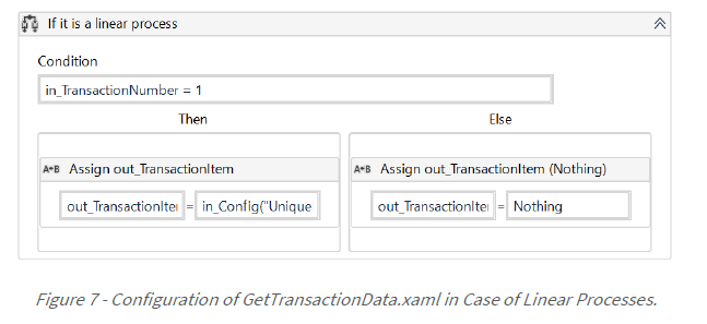

Can we get a similar framework for linear process? Even though we can modify the RE framework for this. It has some problems on retry mechanism etc. Thats why I am asking for a separate framework for linear process.
I found a simple solution in the RE Framework Documentation pdf for Linear process.
“For cases in which there is only a single transaction (i.e., a linear process), the developer should add an If activity to check whether the argument in_TransactionNumber has the value 1 (meaning it is the first and only transaction) and assign the transaction item to out_TransactionItem. In such cases, for any other value of in_TransactionNumber, out_TransactionItem should be set to Nothing (Figure 7).”
