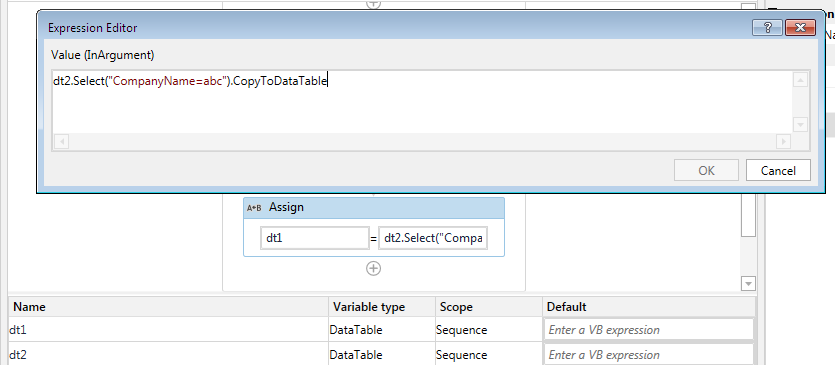

NewDt = ArrDt .CopyToDataTable
from the above sentence NewDt is data table right? but “CopyToDataTable” is not form datatable… showing error like this.
Can u share ur workflow
