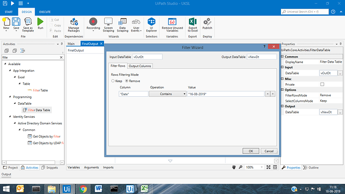

Can I see a screenshot of the filter data table activity to see how you have done it?

in the screenhot, Row Filtering Mode you have set it to Remove. So basically what happens here is, it will look for that date and remove it from the data table leaving rest of the dates in the data table. That’s why you are seeing all the values. I suppose for your requirement this should be set to Keep, not Remove
i even tried using keep filter option…it didn’t work
