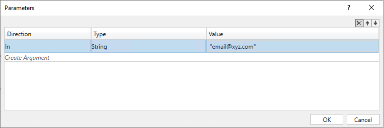

In invoke method u need to paste two things:
  1. dict(“String”) (date that need to be key in dictionary)
  2. String (email).
in targetObject u need to put dict(dateExtracted) - im guessing that dateExtracted is String type
in Paramters u need to paste variable (type of string), and thats all:
If you have problems in Assign validation i’m guessing that sth wrong can be with dict variable.
Can you show me what variables do you have in variable panel?
  2. String (email).
it’s cleared out all of the compilers warnings if you could kindly clarify based on what criteria have you decided to pass dict(dateExtracted) as a targetObject and email as a parameter just for my information?
Thank you
Sure. With invoke method you can add item to list. So, target object is dict(dateExtracted) as list, where you need to add item. It has to be written as dict(dateExtracted), because it gives exactly one list, which was saved to dictionary with key value as dateExtracted.
Email as parameter is the item, which should be added.
