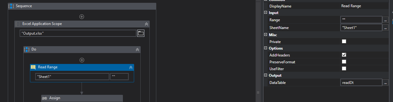

This is my main excel sheet data and i want to extract the data which only contains status=pending into another sheet
This is my workflow …
But its not working properly i dont know why, its showing me only headers not the data

readDT = the Variable Name of our DT form the Read Range Activity :wink:
