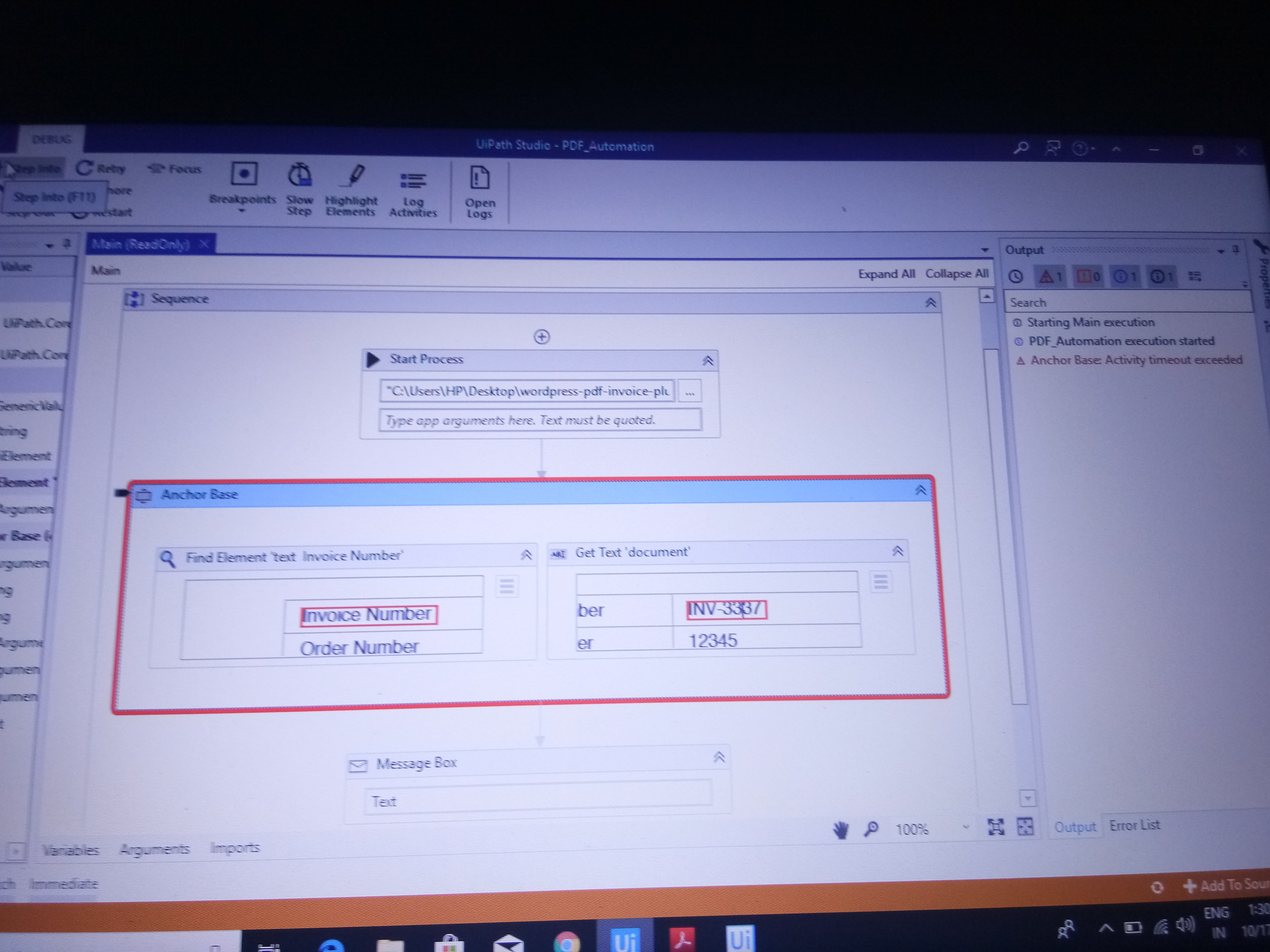

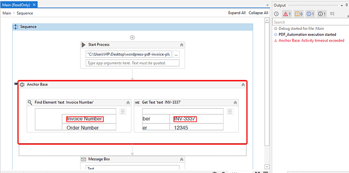

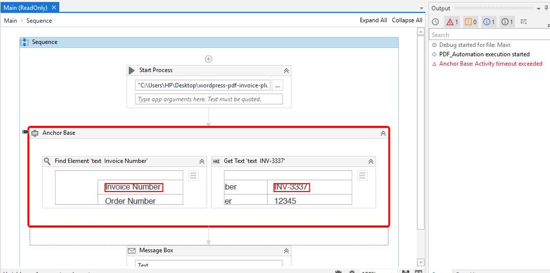

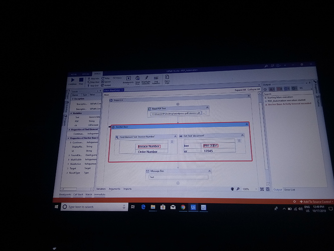

Attached error snapshot for your reference.
I have closed the PDF file but still I am facing issue in find element.

Thanks of the update. But I am not facing issue in read PDF. I have tried start process also still I am facing same issue

Attached my workflow and invoices copy. But still i am facing same issue.
Please help to sort this out.wordpress.pdf (42.6 KB)
