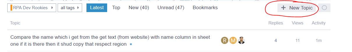

Hi @Mudita123,
Just go to the right category (most likely “Rookies”) and create a post with “New Topic” - make sure it has a good title and you provide enough info to help you asap :slight_smile:
