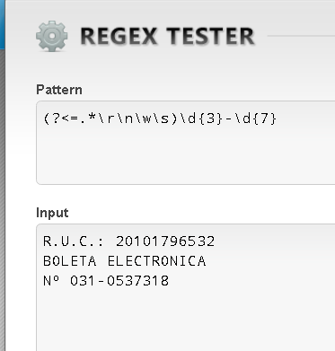

I would like to extract the data that is underlined, this data can be dynamic but it has the same format ### - ########
in uipath study I need to establish a correct rule, since I am selecting all the numbers and I only want the ones below including their script
@borismh - Please try this…
Regex Patter: (?<=.*\r\n\w\s)\d{3}-\d{7} --> If this didn’t work…
Update: Try this - (?<=\n\w\s)\d{3}-\d{7}

Excuse the notepad, I did not show some symbols in the input, so now I do not get the result
@borismh - Do you always get that ° symbol after that N?
@prasath17
yes
@borismh - Here you go
Pattern: (?<=\n\w.\s)\d{3}-\d{7}
