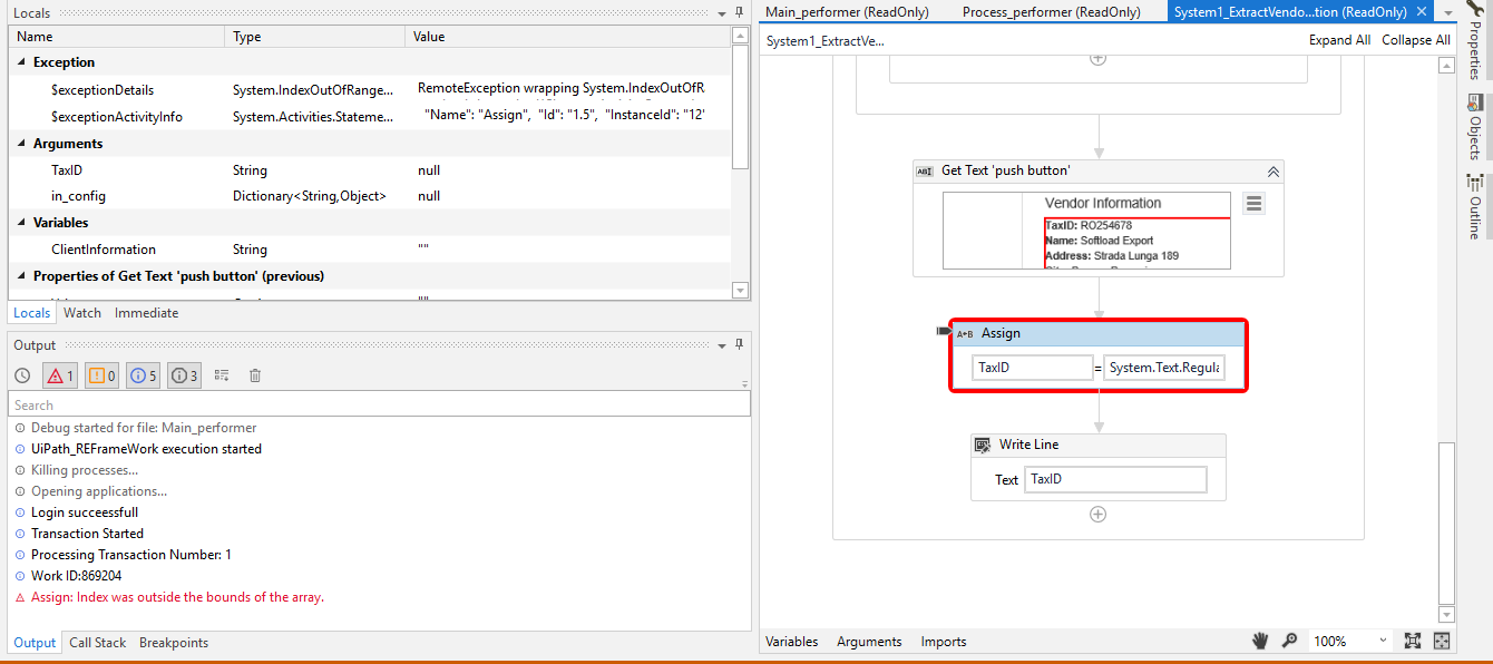

Hi @supermanPunch,
I am referring to the generating yearly report assignment.
I am facing the problem to extract the TaxID from the ACME system.
I tried to use your code with my variable. The Get Text has been assigned to ClientInformation and I would like to extract the first row (TaxID) value. Here is the screenshot:
However, uipath showing there is an error with the code. I cannot detect where is it.
Besides, may I know what does the (0) means at the end of the code?
Thank you.
@Sam_Kong Can you Show us what is the error that you get ? (0) Means that you are selecting the First Element after Splitting the values into an Array.
Hi @supermanPunch
Here is the error:
This is the code that I used to extract the TaxID but was not successful.
I have also tried other code but still having the same error message.

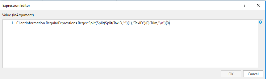

Thank you for the reply.
Here is the error message:
The code I used to run to extract the TaxID is as follow and the output of the Get Text activity is ClientInformation
