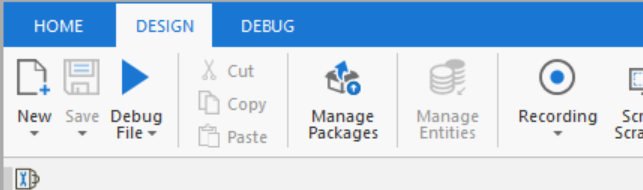

I just recently update to the Studio 2020.10 version and from that on I am missing in den “DESIGN” panel the button “Export as Template” as I had it in the 2019er version.
Here is a screenshot of my panel:
How can I achieve to export a project as a new template in the 2020.10 version?

If your project is Template or Library, “Export as Template” or “Save as Template” doesn’t exist in ribbon menu. Can you create Process type project then check it?
