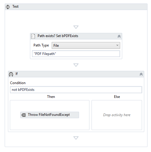

Regarding the second, yes, so something like:
but you will need to throw this using the throw activity, one way to do this would be to check to see if the file exists using a file exists activity, then an if statement like this:
