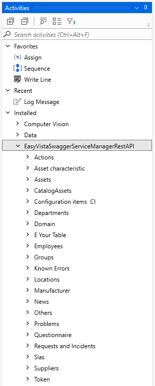

I am trying to import next link https://wiki.easyvista.com/xwiki/bin/download/Documentation/Integration/WebService%20REST/WebHome/Swagger%20file.json?rev=1.1 into a Service, from the library design view and is not working:
I have tried to find a solution browing the forum, but seems to be an old issue that should be fixed. Does anybody how to solve this?

Hi @kristopherk,
Please, finde next the information displayed in the Output Panel:
Indeed, the same happens when just one operation is selected. So I don’t really know why it can recognise every method but none can be imported or created automatically.
