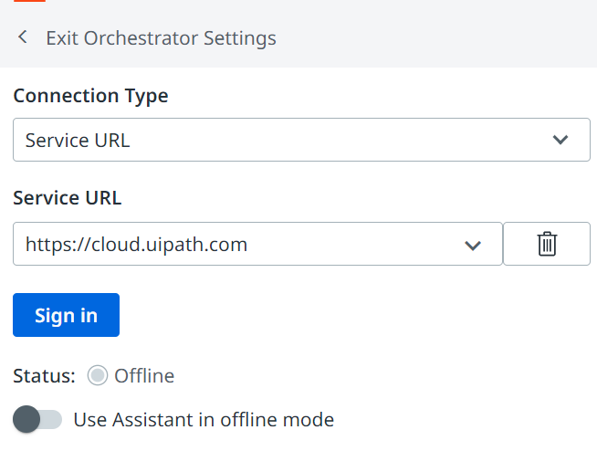

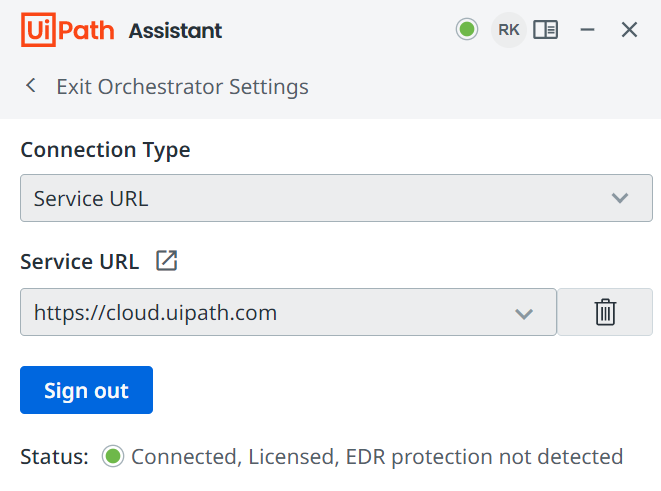

Hello,
Please navigate to Preferences β Orchestrator Settings and sign out. Afterward, sign in using the service URL.
Attached is a screenshot for your reference.
After that you will get the connect page.
