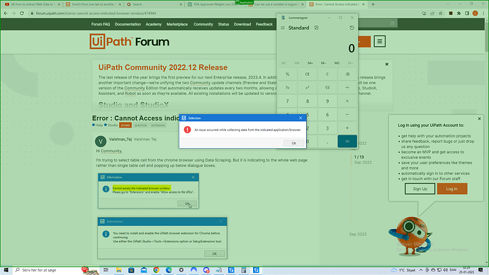

ERROR - I can't use the activity "use application/browser"
It worked fine in the beginning and then all of a sudden this error popped up:
and i tried on different application but it was the same on everything.

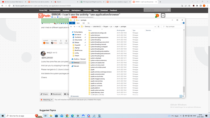

Looks like some files are corrupted…did you try restarting the studio again?
And can you try stopping th services and start again…
Please navigate to C:\Users\<Username>\.nuget\packages
And delete the system packages and ui automation packages folder and reopen the project and check

UiPath.system.activities and UiPath.uiautomation.activities
Didnt work :frowning:

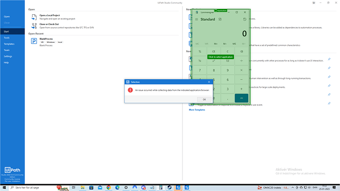

Still didnt work, and i discovered that there is another error aswell. When i try to run the file it says this:
I might try another computer.
