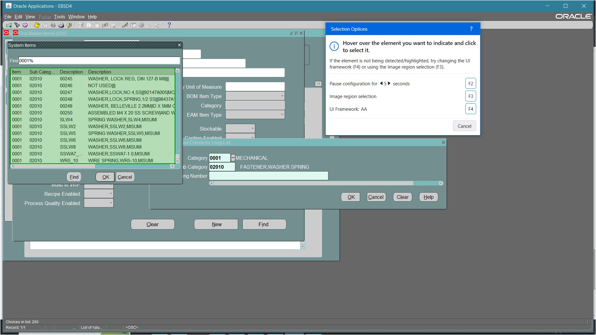

Hi All, I am facing an issue where my dynamic selector for click is not working. For current process flow, currently I have configured it where it can get the last 5 digits from System Item description in Oracle EBS. I would like to know how can I configure the robot to click the last 5 digits detected from the System Item window as the position could be dynamic. The variable i used is {last_description}. Need assistance on how to resolve this issue, and help is appreciated. Thank you.

As you see from my screenshot, I cannot click on the row to select the individual records as it captures the whole data. After I captured and view using UiExplorer, it captures the information as below:
As for the Click activity target, I tried to add in the attributes for dynamic selector it is also not working. The information is as below:
Fyi, I have tried innertext, name and value were not working.

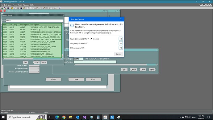

Hi @dvkc91
Can you try to change UIFramework(F4) in click activity.
Hi @lrtetala
Still the same issue as compared with Default.

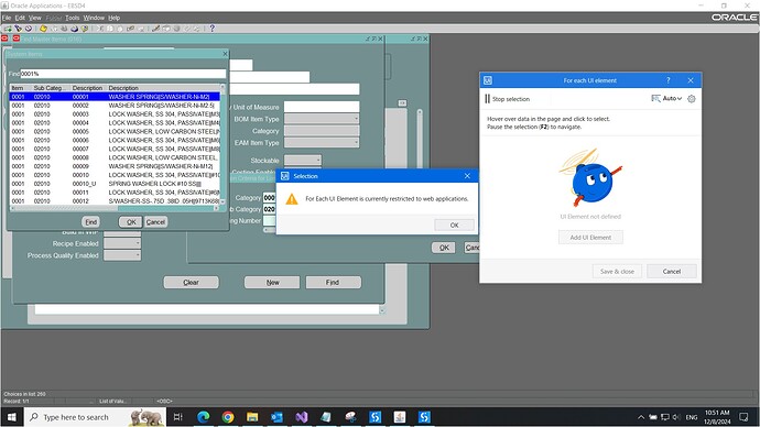

Try with for each ui element activity
Hi @lrtetala
I am unable to use for each ui element activity as it mentioned only supports web application.
Is there any other solutions that could resolve this issue?
