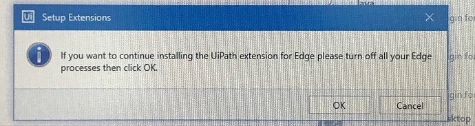

I’m getting the above issue while trying to install the edge extension . please help
Hi @aishwarya1
Can you please any opened edge browser tabs and try again to install. If the issue still exists try to kill Edge from the background processes from Task manager.
Rajeswari
