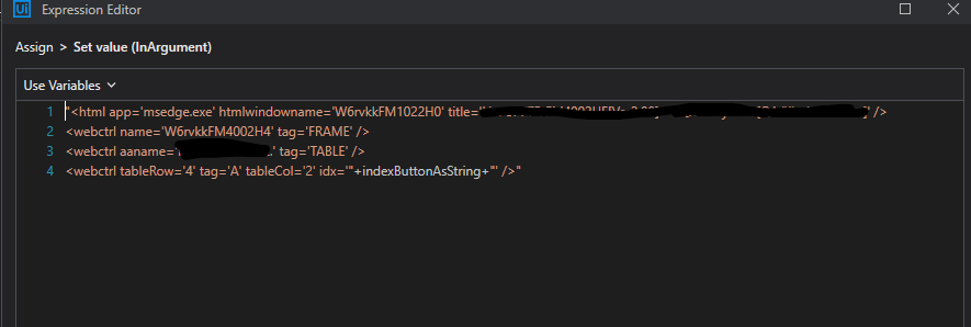

i want to click each word (the principe like button) and after that the button will be download the file. in my workplace, the each word will be change for any categories. so i make it the dynamic selector for click the button using for each ui element. but when i run the UiPath, i get the notification like “Could not find the user interface (UI) element for this action”. and the robot only click the 1 button and not click the other button. please anyone can share the solution about this problem? thanks

In the selector table row is already constant…so even if you change idx it would still click the same
To make a selector dynamic you should remove all the constant parts and use the ones which are same across buttons
I have unselected properties with constant values, but I haven’t unselected for tabelrow and tabelcol because the buttons are located in those tabelrow and tabelcol. The value of Variable is still not change from default value

Then why are you trying to change the idx?
Fo you have multiple buttons in the same cell?
because when i change the idx value, example 1 to 2 then the button when selected was changed so i think is worth to change the value of idx use increase variable. But actually, is not working. Do you have any idea or another way for solving this issue?

As per screenshot…looks like tablerow,tag and idx should do the job in the selector…
Or from the cell extract all tag A using find children or use for eqch ui element on the value you need…it would click on each tag inside that cell

Ideally it would work…just refine the selector and make sure it does not contain any page specific information
