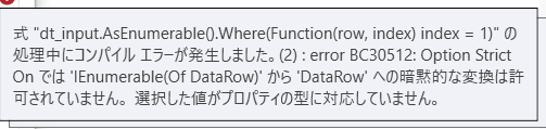

arr_dr=dt_input.Select()
dr_work=arr_dr(1)
を代入文で実行後、
InvokeMethodアクティビティでInsertATメソッドを実行すればできそうですが、
別案として、
dr_filteredRows = dt_input.AsEnumerable().Where(Function(row, index) index = 1)
dt_input2 = dr_filteredRows.CopyToDataTable()
を実行してみましたが、1行目で添付のエラーが出ました。1行目をどう修正すればよいでしょうか?

No.My suggested variable is dr_filteredRows NOT dt_filteredRows.
dr_filteredRows is DataRow.
@gorby
That Variable type not be Datarow you need to change to IEnumerable(Of DataRow) or
you can use in one line instead two lines of code
dt_input2 = dt_input.AsEnumerable().Where(Function(row, index) index = 1).CopyToDataTable()

Hi,Thank you for your advice!
After changing variable type from Datarow Array to IEnumerable(Of DataRow),
I confirmed the next two lines work.
IEdr_filteredRows = dt_input.AsEnumerable().Where(Function(row, index) index = 1)
dt_input2 = IEdr_filteredRows.CopyToDataTable()
