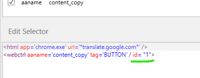

Could you send screen shot what edit selector window show after click activity clicks image
We could compare few of them . In best case scenerio, there is some sort of index id number like this image
If you find something like this. you can make a loop which will put there increased number for each step

There is no index id number… However I note that the “ctl02” increases for each line. So the first line is ctl02, the second line would be ctl03.

In you example I think regex might not work, sorry for confusion, I’v expected something different. However you can “inject” string in selectors f.e like this
And make a loop in order to “rotate” those on page
idFull would be idHead+lineNumber.ToString+idTail
Sorry to send you this like that, but somehow I cannot add file. Let me know if something is unclear :slight_smile:
