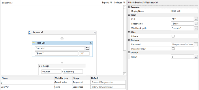

Can you try to use GenericValue type variable at Result property, then convert it to your target type, as the following?
