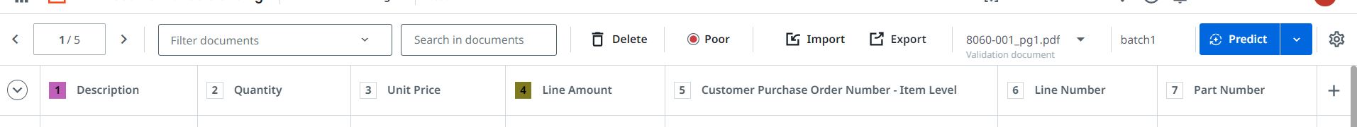

@Anil_G would you please let me know how to use the semi-structured form AI extractors? I’ve been only using the form AI by creating the end points, but the semi-structured form AI don’t have a publish button…
thank you so much for your time!
@lynnsong986
For what?
Once the labelling is done you need to run the pipeline
I haven’t done anything with pipeline and found the documentation confusing, is there a video or link that demonstrate this piece? thank you!

So basically you need to follow the below
  1. Upload your docs
  2. Choose a ml model you nees
  3. Label the docs as you need
  4. Then hit on export which would create the required json and all in the dataset
  5. Go to pipelines and select training pipeline…and give the dataset,package and train the mode
  6. Once training is completed select the ml skills and create a skill using the version created after training pipeline
Hope this helps
