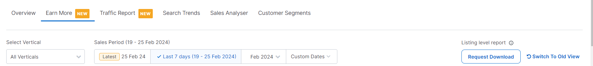

In website I used click activity, to click on “Request Download”. After click on “Request Download” I should wait for few minutes to change as “Download Report” and then I want to click on “Download Report” button.
This steps how to use in “Do While” activity, I want to check max 6 minutes and this need to check every 30seconds. once this change to “Download Report” then click on “Download Report”.
