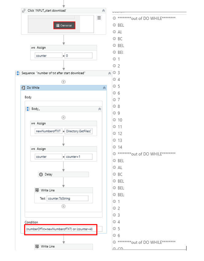

I am using “Do while” to continue with the next download from a website, it does the same as the “Wait for download” activity, but I prefer to do it with “Do While”, the problem occurs when after pressing the button to download, the web page can crash and leave me in an infinite loop, it has rarely happened to me but anyway it is a problem that I want to solve.
So when the page crashes I would like my “DO While” to have a timer and for example stop in 4 min.
It occurs to me to put a second “condition” in “do while”
(numberOfTxt=newNumberofTXT) or (…)
but I don’t know how I could set the timer.

I’ve been testing this way “(numberOfTxt=newNumberofTXT) or (counter<4)”, but the condition after the “or” doesn’t work, it should break the loop but it doesn’t.

Change it to AND
This timer (alone) works fine (it is set to 4 just as an example, I would put that in 120 seconds as a maximum limit). Thanks @postwick @gustavo.cervelin
But I need it to work with the rule I’ve been using:
(numberOfTxt=newNumberofTXT), this would allow me to optimize the time once it detects a new text file to continue the flow with the next download.
When I combine it like this: (numberOfTxt=newNumberofTXT) or (counter<4), it doesn’t work (Doesn’t stop after 4 seconds). What I expect is the following: If the first and the second are successful, stop the loop, I set the time to 4 just to test, but this is not true.
When I combine it like this: (numberOfTxt=newNumberofTXT) or (counter<4), it doesn’t work. What I expect is the following: If the first and the second are successful, stop the loop, I set the time to 4 just to test, but this is not true.
And I necessarily need those two rules the first to optimize times because it waits for the download to finish. And the second to prevent getting stuck in an infinite loop, if the website crashes (it has already happened to me)
I plan to use the “Is True” activity first to validate the logic part, but if you have any suggestions, those are welcome.
As I said, change it to AND.
You only want it to continue if there is no new file AND the counter limit hasn’t been reached. With OR, as long as the first (numberOfTxt=newNumberofTXT) is true, the rest is irrelevant.
You’re absolutely right, I’ve been getting confused. Thank you very much

I was confused that a loop would exit when this was done (numberOfTxt=newNumberofTXT), so I put the “or” (counter<4). That is, if one of the two is affirmative (True “or” True ) then exit the loop.
But I had forgotten that the first statement (numberOfTxt=newNumberofTXT) was to stay in the loop. :sweat_smile:
