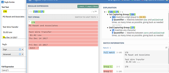

I did some stuff https://regex101.com/ and came up with this…
/([0-9]+)(.*)/s
and that works. Here is the output…
That is how I would like this to come out in the end.
When I do this with a Uipath process though seen here…
My final result looks like it is just returning the whole string without a split…

Not yet, I’m trying to figure out how to build the regex in the actiivity to make it work
There is a discrepancy between online editors and the Regex builder
The reason for the discrepancy is that I wrote my regex in Perl but Uipath uses the .Net implementation so I have to figure out how to write it that way.

I would also like to point out that regex101.com does not have VB.net ’s language and regular expressions are loosely similar between different languages.
If you want something that is more likely to work, I would suggest .NET Regex Tester - Regex Storm .

I have done some work the last few hours and it looks like in order to pull the first line I can use this…
(^\s\d+)
And to get rest of it I use this…
^\ \d+
