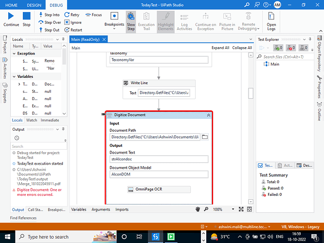

we designed job for extract data from pdf file and save into excel file and call dynamic rest api post method and post the data to server .so we want to upload pdf file in to Digitize document activity and data exraction scope Activity at runtime ,I pass path of pdf file folder with .pdf(“C:\Users\Ashwini\Documents\UiPath\TodayTest\output”,".pdf")But getting error (Digitize Document: Input document not found: output*.pdf)
Please guide me how can pass path of pdf file
Kindly check attached screenshot.

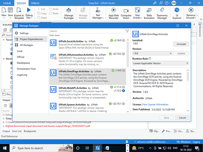

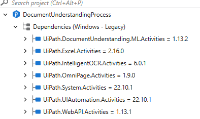

Also, Try updating the IntelligentOCR Packages to the latest stable version or update to the following versions :
Let us know the results again.

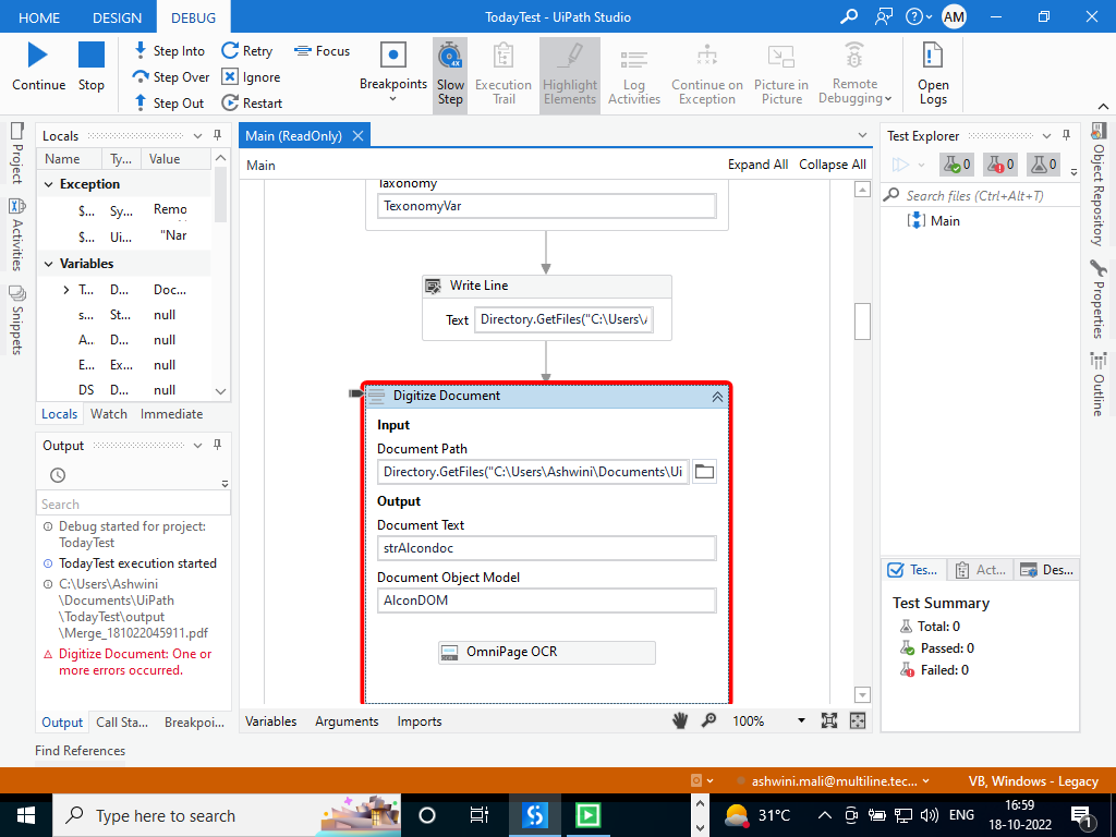

Add write line activity and checked proper file pick or not so you can see that its pick file but getting error at dizitize document activity.
please guide me
Have you tried updating the packages or updating it to the versions as mentioned above ?
When i pass original pdf file so Activity run properly
