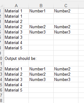

I have a problem. I have an Excel list and there are some duplicates in it. I would like to delete all duplicates but only those in which there is nothing in the last cells. (See Excel example).
Do you have any ideas?
The standard function with Remove Rows did not work.
Excel.xlsx (8.9 KB)

Thanks for your message. I have tried it but unfortunately it does not recognise it as a duplicate because the other columns contain values. Only the first column is the same.

I have also tried but unfortunately it deletes some of the wrong duplicates, I am only allowed to delete the rows in which the value is only in the first column and nothing in the second column.

Hi, thanks for your message. I also tried it but the lines still remain as in the screenshot above.

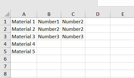

DT.AsEnumerable() _
  .GroupBy(Function(row) row.Item(0).ToString()) _
  .SelectMany(Function(Group) If(Group.Skip(1).Any(), Group.Skip(1), Group.Take(1))) _
  .CopyToDataTable()
Input:
Output:
Thank you very much! This works!
