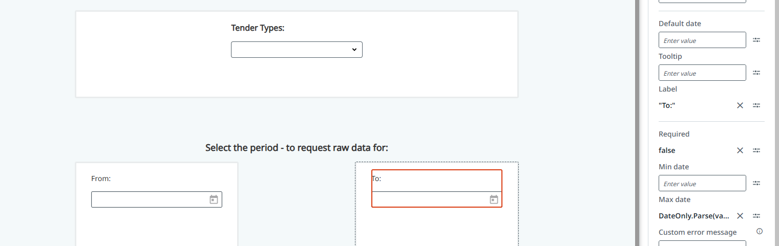

I have date picker in my app,
But the output of the date is defaulted to no date,
how can I sort my date picker out.

Hi @Aki1111
  • Min date just defines the earliest selectable date, not the default (selected) date.
  • The “Default value” (the property right above or below it) determines what’s shown initially.
  • If that property isn’t set (or the expression evaluates to null / Nothing), the control will appear empty.
  • var_start_date actually contains a valid date string (like "2025-10-06" or "10/06/2025" depending on locale).
  • It’s assigned before the page loads (e.g., in an “On Page Load” rule).
  • If you want “today” as default
    You can directly set:
    DateOnly.FromDateTime(DateTime.Now)
    That will show today’s date by default.
Hope this helps.
Regards.
I put it as the default value. - this the output

@Aki1111,
If you want to set output with selected Date from picker, you can apply these steps like below. There is no direct output property. You can add a rule under Events tab like this.
Regards.
Hi
This is the error I get,
Can you change the type of the variable as string?
The variable type in Item to Set must be string.
Regards.
Hi @Aki1111,
please always try to provide as much information as possible — the more details we have, the better we can support you.
What @tolga.kamci suggested should do the trick.
Your error message simply states that there’s a mismatch between two values.
Best regards
Thank you so much this worked
