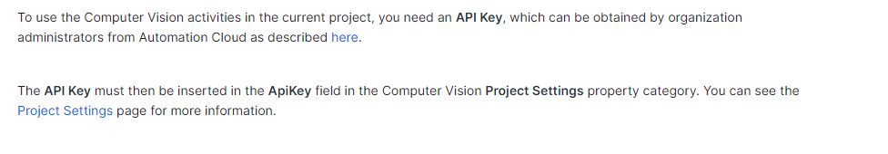

API Key is mandatory and you can use it for any project.
detailly you can check here https://docs.uipath.com/activities/other/latest/user-guide/about-the-computer-vision-activities

I totally confused about your question. according to the link I shared. it is clear that you need API Key.
how can the CV activity give you results without an API key? this is make me confused.
