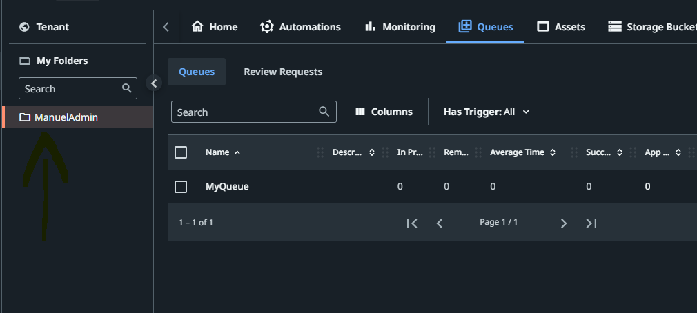

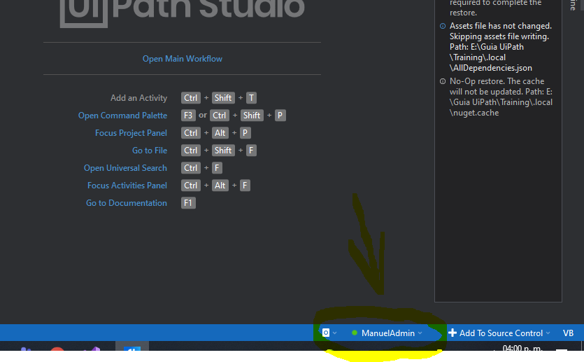

As you can see I am connected to this folder
In this case I can use All the Elements (Assets, queues etc) of this folder and I do not need to specify the folder path, in the activities.
But if your studio is aiming to another folder and you Credential is store in another one you need to specify it
eg: In my case will be “ManuelAdmin” or if you have subfolders will be “ManuelAdmin/Subfolder”

“2- How do I make sure this happens? I see in the properties the option of “Orchestrator Folder Path”, is this what you are referring to? If so, how do I obtain this path?”
In Orchestrator the section on the left side under “My Folders” shows you the folders you have access to.
