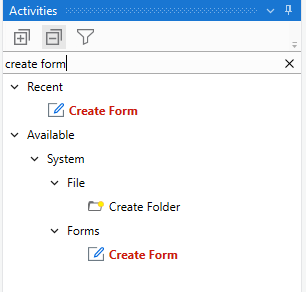

Create Form Does Not Open When Process is Running
I switched it to modern and still do not see the Create Form activity. Can you please share your configuration

I got it to work. I downgraded UiPath.Form.Activites to 1.1.11 and I removed the UiPath.FormActivityLibrary package
I would try upgrading Form Activities back to the latest version. The issue was probably a conflict with the FormActivityLibrary package.
When you’re trying to solve an issue like this, you should only make one small change at a time. By downgrading one package and removing another, you don’t know which was actually the solution.
