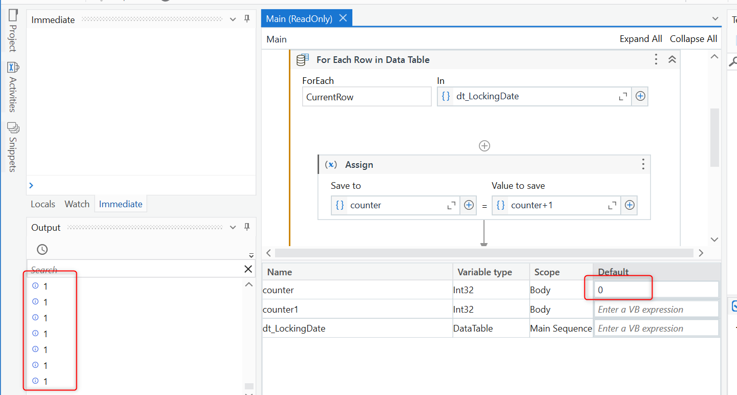

Assigned the default for counter value as 0 and increasing +1 in each iteration… but it is not increasing
attached workflow

have a look at the index output of the for each row acitvity wihich is returning the loop counter out of the box
otherwise change the scope of your counter to a higher scope
Hi @Sathish_Kumar_S The file was not opening. I see the scope of the Counter
var in the screenshot is Body
. Can you please change the scope of this variable to Main Sequence
and check
