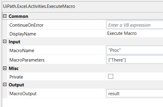

Hi all expert,
Does anybody have a example how to use Execute macro with “Macro output” option? I think that is a variable to get returned object from RPA process, but I’m not quite sure how to use that. So if anybody have sample of it, please kindly provide me.

Hello There,
Create the macro Function instead of Sub, cause Sub will not return but function does
Function Proc(Optional sParam1 As String) Proc = "Hello " & sParam1 & “!” End Function
Assign to a variable in Macro output and message box it
