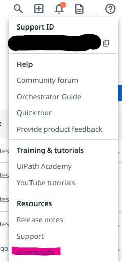

Hi guys, I just downloaded the latest Studio Enterprise Edition and reinstalled it and it worked. Thx a lot.
