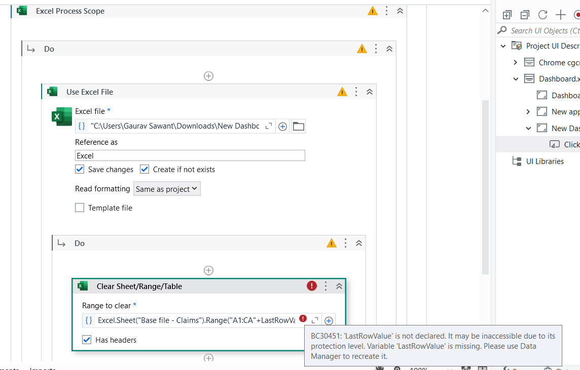

Can you show your full workflow what you did… @yogitagaikwad2206
This is my full workflow
first i’m trying to check record is delete or not but it gives an error
