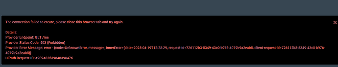

workbook activity, I see a connect to one drive and share point button. When I use this I am asked to sign into my office 365 account, following which I get an error :
Details: Provider Endpoint: GET /me Provider Status Code: 403 (Forbidden) Provider Error Message: error - {code=UnknownError, message=, innerError={date=2025-04-19T11:01:15, request-id=6715b2db-9f51-41bc-a14b-9b2215f53fa4, client-request-id=6715b2db-9f51-41bc-a14b-9b2215f53fa4}} UiPath Request ID: 959902930753507039

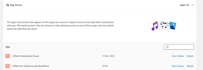

Furthermore , I can see from my office 365 account that the permissions are enabled for UI path. However I should be prompted to enable these permissions from a window when I enter my password.

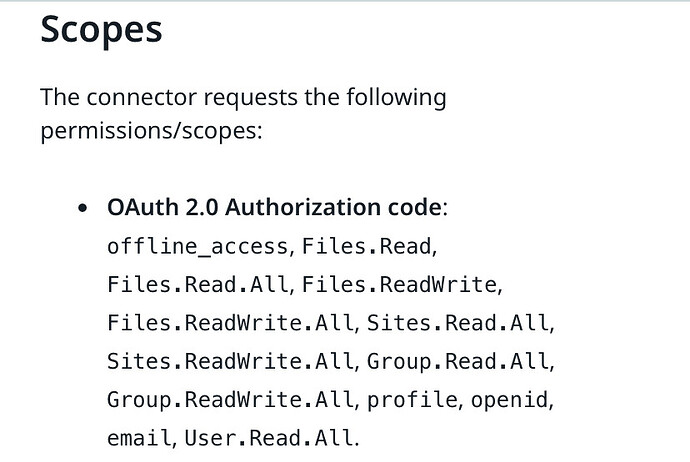

The option you are using to connect requires below permissions enabled, can you check if you have those set?
I am guessing because the connection failed , I could not grant permissions to for all of this . From my office 365 account UI path only has permission to read my profile.
Then that’s the issue, documentation states this auth type needs to have those permissions enabled.

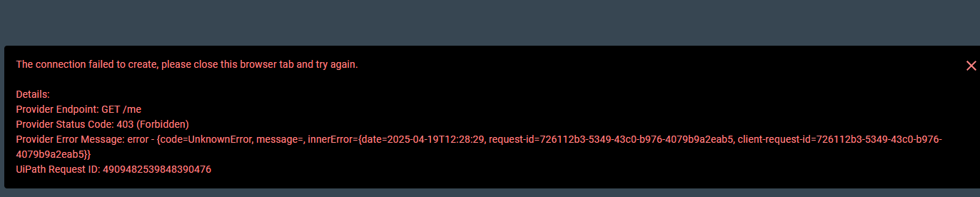

I still get the error , hmmmm

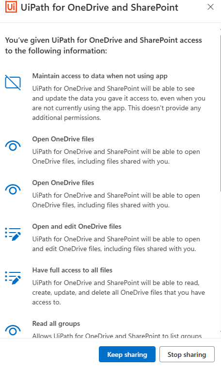

Can you share screenshot of the permissions you have enabled currently?
@Tobi_Anthony
I still see SharePoint site’s permission and few other permissions missing
Its there , sorry I did not scroll below in the previous screen shot

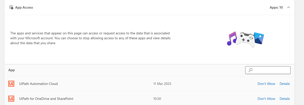

@Tobi_Anthony
Are you able to see site’s permission?
I am not able to find it, can only see for fikea, group and profile and email
not sure if this helps
