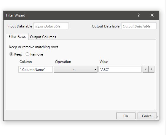

You can use filter data table activity to achieve your requirement…
Have a look on this image
