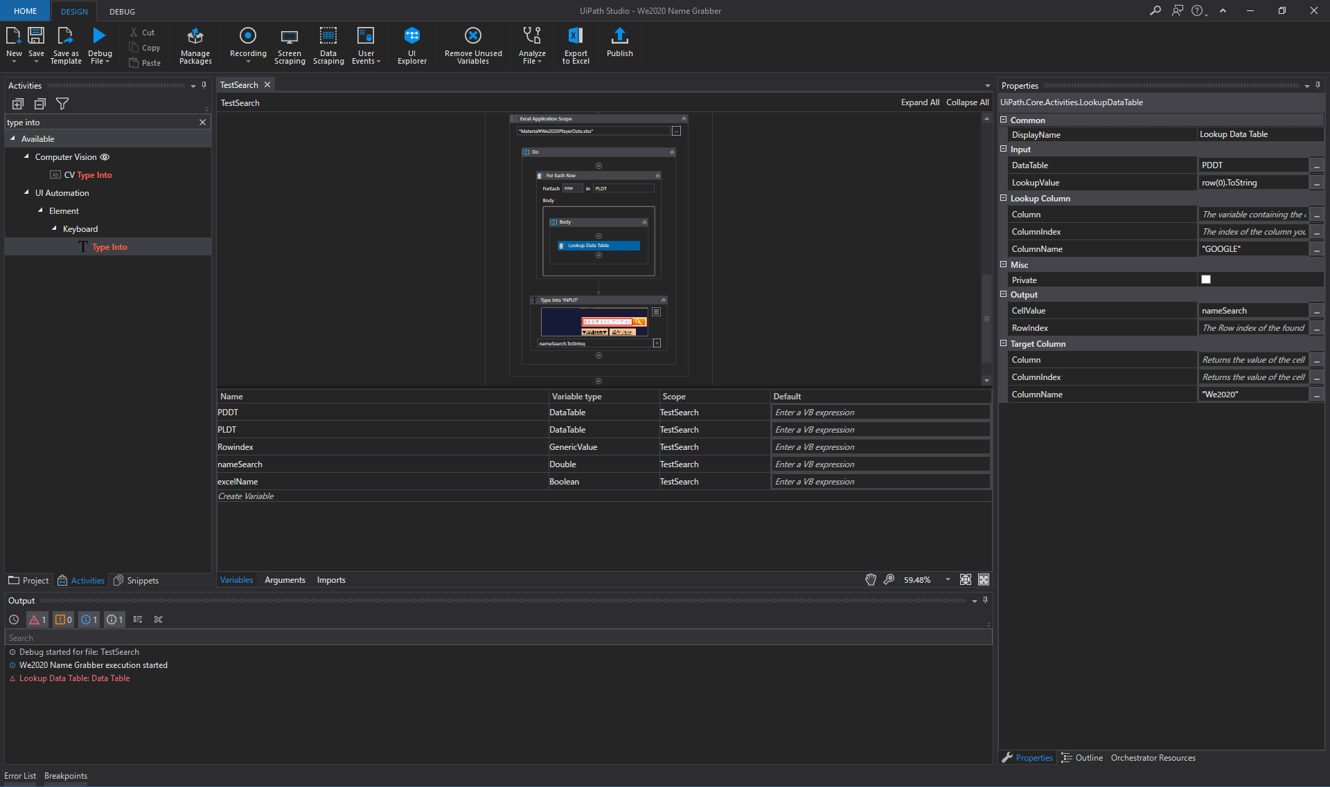

Hey @samir
I tried your reccomendation of using Lookup Datatable. It looks promising in terms of what I want to do but I get hit with an error. I am not sure I am setting everything up correctly…
- Check if value from PLDT exists in PDDT
- If it exists, get cell value from the column on the left of the existing value
- Type into a search box
Now the error is saying “Lookup Data Table: DoubleConverter cannot convert from (null).” instead. Where am I missing out on the data extraction…?
