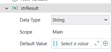

@fernando_zuluaga thanks a lot. But I am getting an error. Any idea where my error is?
Hey
strResult is String type?
Yes it is. Do I need to set a default value?
