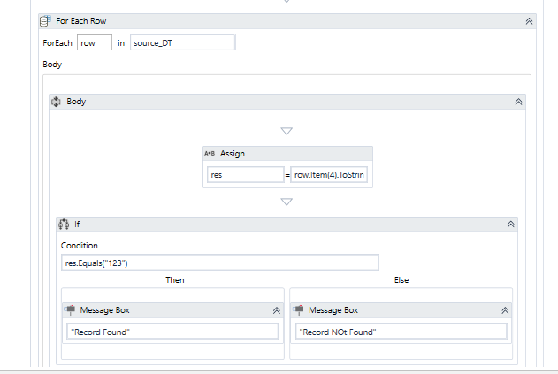

@sapta_619
  1. use Read Range activity to read the data from excel and will give you output as dataTable.
  2. Then use ForEach Row activity to iterate that dataTable and check with IF condition.
ForEach row in dataTableName
If row.Item(3).Tostring.Equals(“123”)
then found’
else not found
Here, item(3) referes to 4th Column.

Logic
You can use the for each row activity to achieve it.
Problem with for each row, it will search in 1st row first then 2nd row and will carry on, putting if logic here will show if that string does not exist in row 1 or row 2 … then it will proceed doing some job which i don’t want.
I want to check the datatable whether the string exists or not for all rows for respective column index
