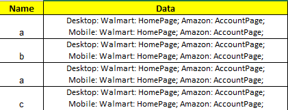

See this , i want to search in this column whether “uipath” is available or not
Any idea?
