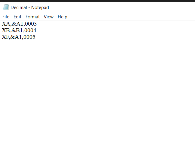

I have a data table and while writing it into a text file it is written with a delimiter as “,” and I need to separate it using a “tab”.
For Reference I have attached screen shots of what I am getting and What I need as an output.
Output we are getting :-
Output we want:-
Can anyone suggest any solution for the same please?

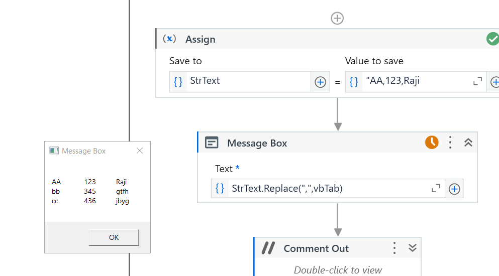

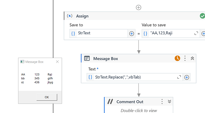

// InputText is the string variable containing the content of the text file
Assign: ModifiedText = InputText.Replace(",", vbTab)
