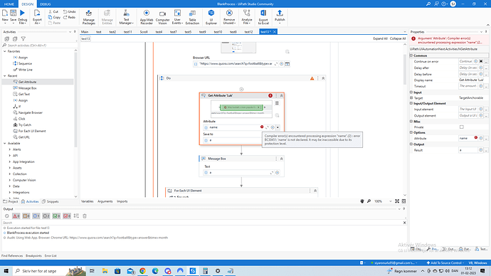

Im using get attribute and im trying to get “name” from the browser tab.
But it makes an error:
btw “aaname” dosent work either.
Hi @john_johnsen
Indicate on the inner screen and check once
Regards
Sudharsan

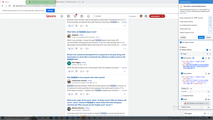

Hi @john_johnsen ,
Could you Check the attribute values by using the UiExplorer, You might be able to get a clear idea on the attribute that needs to be used for name/Title extraction.
Ok i made it work but, now there is another problem.
My second tab is dynamic, how do i make the seleltor pick the second tab UI all the time?
@john_johnsen ,
Could you let us know if the Tab is being opened by the Robot/Process or if it would be already opened ?
I figured it out, i just had to use an anchor on my first tab. thanks alot
