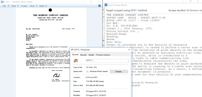

You can use UI automation to extract text from each page in your Tiff file.
Open the Tiff file in Windows Photo Viewer, or any other photo viewer that works, use the Screen Scraping wizard to get the text using OCR. Then go to next page using a Click activity and repeat the Screen Scraping.
Of course, you can use a loop activity to do this for each page in your Tiff file.
