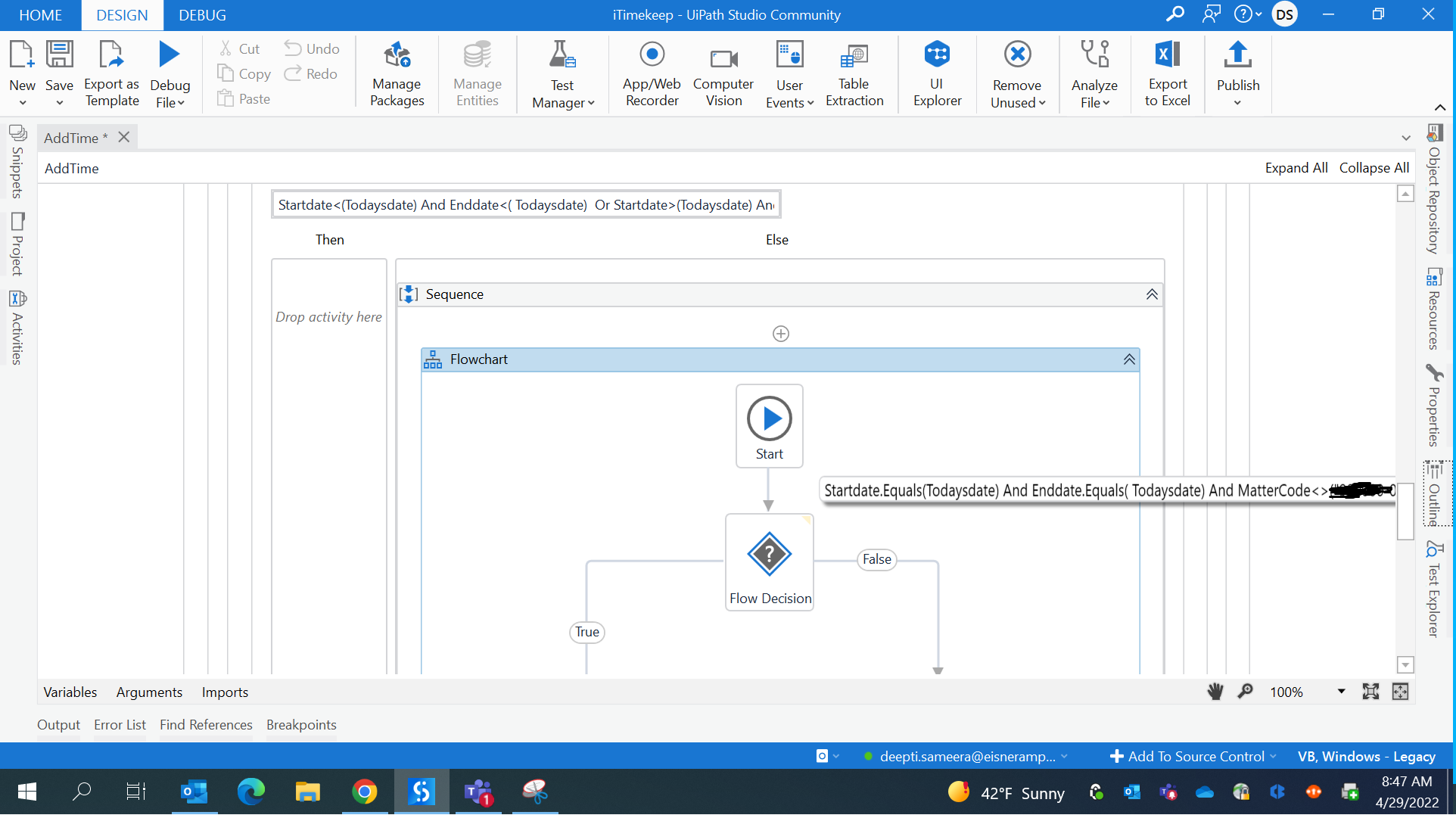

Hi Following are the screen shots of my if condition:
Sorry for the late reply. Can you run your script in Debug mode step by step to troubleshoot the issue? I could not figure out what goes wrong based on the screenshot.
Hello @sairama.deepthi ,
As you need to check multiple conditions here, better to output the data from excel in a message box and execute it in Debug mode step into. Then you can see how the flow is happening for each data and which condition is failing.
Based on that we can help you to solve the issue.
