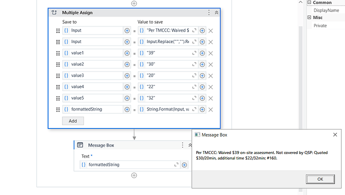

Check the below flow for better understanding @manojmanu.rpa
Input = "Per TMCCC: Waived $‘{0}’ on-site assessment. Not covered by QSP: Quoted $‘{1}’/‘{2}‘min, additional time $’{3}’/'{4}'min; #160."
Input = Input.Replace("‘","").Replace("’","").Replace("'","")
value1 = "39"
value2 = "30"
value3 = "20"
value4 = "22"
value5 = "32"
formattedString = String.Format(Input, value1, value2, value3, value4, value5)
FLOW:
Regards
