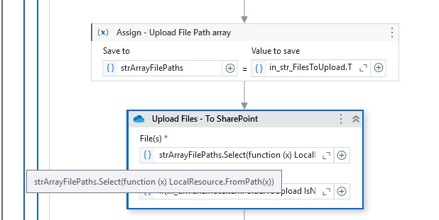

Here is how you can pass multiple files to Upload File
  1. Get all the local file full paths in an string array
  2. use this expression in Files property of Upload File activity strArrayFilePaths.Select(function (x) LocalResource.FromPath(x))

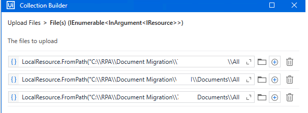

Regarding the multiple file option, yes it can support multiple files by adding them into arguments as shown below . I have tested it with 5 files and haven’t seen much speed improvement while doing this vs loop each file & upload (Not sure and this may be due to small data set being used for testing)
I haven’t been able to figure out how to get a collection to be passed into this argument so that the files are loaded at once. Additionally, the number of files inside the folder will be dynamic “Add entry” option might not be suitable here. I am not sure how i can get to build an IResource object collection from local file so that i can try passing it here. Requesting your expertise to see how this can be done, if possible.
