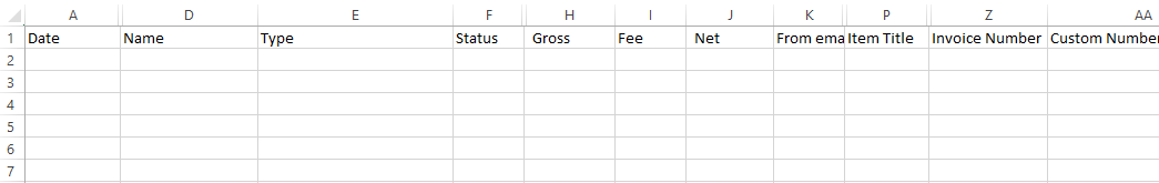

Hi @richarddenton, i am trying this assign activity to update 3 columns however nothing happened. Can you please help out? thanks. Want to change the column named “Name” with new name. Appreciate your help.
See below screenshots.
here is my excel:
rename1
Full editor screenshot:
rename2
