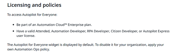

I’m facing an issue when opening the autopilot “The feature not enabled in your organization”
my orchestrator is on-prem standalone 2024.10.1, my studio is 2024.10.
How can I enable it? Is it available on-prim, or do I need the automation suite?
yes, i have checked and the on-prem standalone not mentioned
i think it’s works just on cloud
