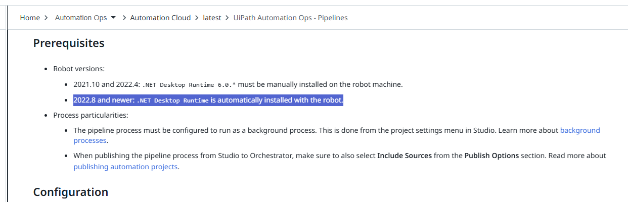

I’ll try the same, as I’m getting similar issue. Though documentation states that for relatively new robots (2022.8 and newer) .Net Framework is automatically installed. And it also requires .Net Runtime, not SDK - though I’m sure Runtime is included in SDK.
Edit: I won’t be allowed to install .Net 6.0 SDK as it’s not supported anymore. We have .NET 8.0 SDK on that machine though.
